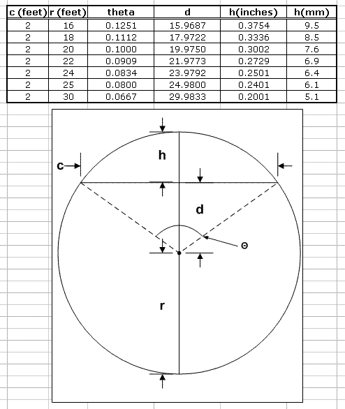

Here are some calculations for figuring out the dimensions of a 2ft radius dish:
PostPosted: Thu Aug 04, 2005 1:46 am
